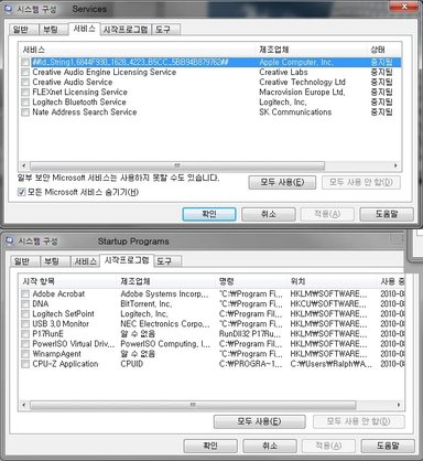

Scratch my last addition , going one to step 2 clean boot , all start up programs are off and problem persists , this bitch is tough ...
I made a crude print screen , have a look if you'd like .
Now all my startup Programs and NON microsoft services are switched off ...
Sorry for the OS language , I have to life and breath Korean for a living...
Any off these seem out of place and are any notorious for screwing up internet connections ?
It's getting late for me , and going to have to try them one by one tomorrow ,
I never knew about these kind of possibilities within windows , I am more of a impatient
and direct , delete-and-try-again personality , thanks for the help ...
Ralph
