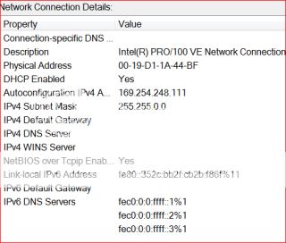

My computer is running on Window 7 and is no longer recognized in my network. It's under unidentified network, and i was using an ethernet wire. Please give me some advice or tips to fix this problem. This occurrence happened when I was on an mmorpg. The screen seemed to freeze, so i restarted the pc. Then i could no longer reconnect to the internet. My other pc and laptop can still connect though.
Here's more info:

The first thing you might try, since it seems that you are not getting proper IP addressing information from the router, is to manually assign static values for IPv4 in the properties of your "local area connection", network adapter. If you need help with this please post back, but you should be able to obtain an idea as to what they should be by perhaps examinining another computer on the same network and then make sure that the actual IP is one off and unique. An example might be something like;
192.168.0.222 (ip address)
255.255.255.0 (subnet mask)
192.168.0.1 (default gateway, assuming that is the address of your router)
192.168.0.1 (dns server, assuming that is the address of your router)(you may consider altering that to reflect...

Thanks for the advice, but my computer is still not connecting to my private network. I forgot to add that when i put ipconfig/release there is an error i cannot release or renew my ip address for the pc.
