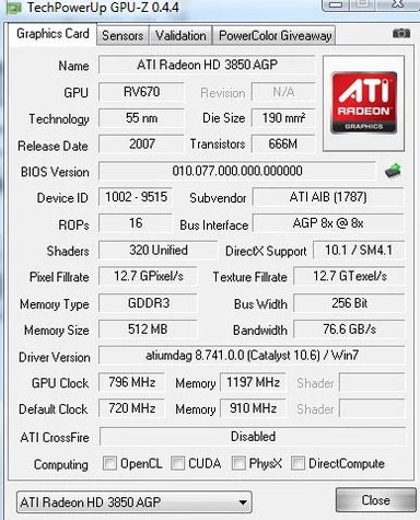

Your graphics solution isn't all too great for gaming. The reason this is, is mainly because of the fact it only has a 64 bit bus width for the memory. Even on my AGP card (HIS Radeon 3850 - special card you can see in specs) - I have a 256 bit memory bus width. What I'm saying is that you might have to lower the resolution of games to play well.
If you'd like to compare to see, here is a screenshot of my AGP card in GPU-Z. You can also download GPU-Z to see the differences and why it may not be playing so well as you'd expect:
