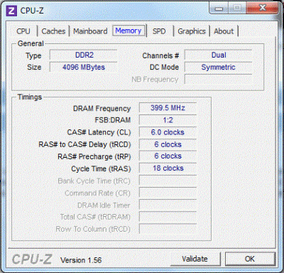

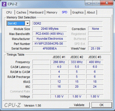

I don't understand taking a screenshot of the spd means (I don't know what the spd is) and I'm checking out CPU-Z now.
It will be obvious when you run CPU-Z.

I had my re-install working as well as I could, until Explorer just froze up and I held down the power button to cut it off. Now whenever I try to boot it, I just get a blank screen after the BIOS. I'm on my old hard drive at the moment, with the ever-present "hard drive failure imminent" message on start-up. From the sounds this thing makes, I believe it...but not much choice right now. Here's those screens you asked for, since I would expect those tabs to be the same regardless of my current hard drive. Also, I could not find a "load optimized defaults" option but I'm about to go look again after flashing my BIOS to the latest version.
