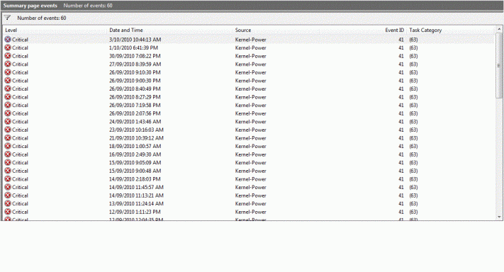

heres the tiff file from the event log and minidump file. Is this what you need?
Jono

nvm62x32 nvm62x32.sys Fri Oct 17 17:00:39 2008 is still present. Navigate to C:\Windows\System32\drivers and rename it to nvm62x32.BAK
Reboot. If bsods continue, test memory overnight with Memtest86+.
You didn't update the video card driver yet either.
Keep us updated regardless of result, please.
