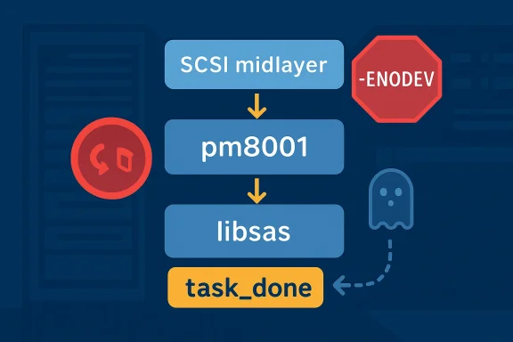

Schematic graphic showing SCSI midlayer downloading pm8001 and libsas before task_done.

At the heart of CVE-2026-23306 is a mismatch between state handling and return value semantics. In the vulnerable path, pm8001_queue_command() sees a phy-down or device-gone condition, updates the task status, and calls task_done to tell the upper layer the task has been handled. That means the SAS task object is already effectively consumed. But the function then returns -ENODEV, which says to the caller that the command failed to queue and still needs cleanup. Those two messages cannot both be true, and the caller trusts the return value over the hidden side effect.
The result is a double free. Once libsas receives -ENODEV, sas_ata_qc_issue() assumes the LLDD did not take ownership of the task and performs its own cleanup. That cleanup path frees the SAS task again, even though task_done has already freed the underlying object. In kernel memory management, that kind of duplicate reclamation is especially dangerous because allocator metadata can be corrupted, and subsequent pointer reuse may become unpredictable.
