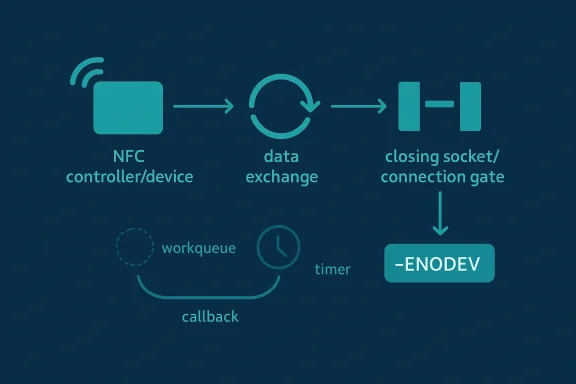

The Linux kernel’s NFC stack is getting a small but important correctness fix in CVE-2026-23330, and the problem is exactly the kind of lifecycle bug that kernel maintainers try to stamp out early. In nci_close_device(), the kernel now completes any pending data exchange before the NFC device is shut down, preventing a socket reference from being left behind when the callback never gets a chance to finish cleanly. The upstream stable patch describes the issue as a leak observed by NIPA, with the callback path holding a socket reference that could survive device close if the exchange was not explicitly completed first.

The patch content shows that nci_close_device() already had to flush command work, delete timers, and unwind internal flags. The new change adds one more requirement: if NCI_DATA_EXCHANGE is still active, the kernel must call nci_data_exchange_complete() with -ENODEV before final close. That is a classic kernel design move: rather than letting a pending operation dangle, the code forces completion with an error so every holder of a reference gets a deterministic end state.

The stable patch is only nine added lines, but those lines close the exact hole described by the vulnerability report. In both branches of the close logic shown in the diff, the kernel now checks whether the data exchange bit is set and, if so, completes the exchange with an explicit -ENODEV error. That error tells the callback path that the device is no longer available and that teardown is in progress.
Why -ENODEV matters​
Using -ENODEV is not just a convenient return code. It is the kernel’s way of saying that the hardware or logical device is gone, so any outstanding operation must stop depending on it. In effect, the close path is now making the asynchronous state machine consistent rather than hoping a deferred callback arrives in time.
This is also why the patch is better than a simple “wait and hope” approach. The close routine already flushes relevant workqueues and timers, but the data exchange callback itself is the object that owns the socket reference, so the teardown has to explicitly resolve that ownership. Otherwise, the kernel can clean up the transport shell while leaving the payload of the operation alive in a half-finished state.
