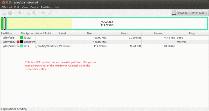

While you are there, Ubuntu has a Partition Manager called GParted. If you want to use it like you would Disk Management in Windows 7, start it up. Go to the top icon on the menu (Dash Home) and open the window. On the top is a search bar and type GPa... then select and start it.
