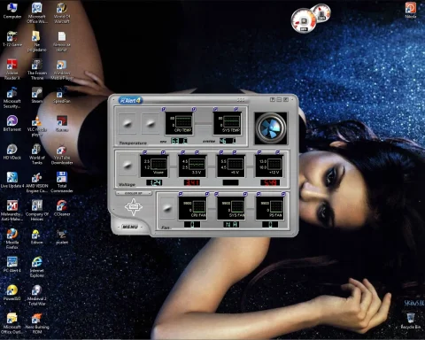

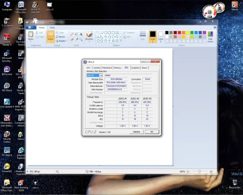

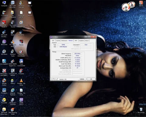

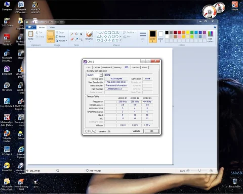

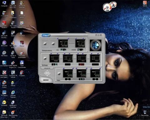

Hi guys it is me again<br>
Since last time i posted mine bsods have stopped for some time but now they are back in full force. They appear when i attempt to play any game on pc and they dont stop after restarting in safe mod only if i turn my pc of and leave it like that for a while. Here are my minidumps<br>
edit: i dont have CPU-Z but i have pcalert here are

Let us know how it goes. If you get further problems with blue screens, attach your new dump files and details and we'll move on from there.
You may need to enable DriverVerifier if BSOD's continue.
HTH.
#4
tnx for answering but i dont really know what to do with
giveio.sys Thu Apr 04 03:33:25 1996 ADC Analyzer/SwiftForth/Disspy?? is that driver i need to install
Elmer
Extraordinary Member
#5
No. It's a driver you need to update. It could possibly be related to Speedfan but I didn't mention that as you have an updated Speedfan driver from December 2010.
You could rename the driver from giveio.sys to giveio.bak. This will "break" whatever it is related to, maybe Speedfan, maybe a.n. other. I'm assuming none of the names I listed above (ADC Analyzer or SwiftForth or Disspy**) mean anything?
(**Mean nothing to me either!!)
#6
you are right it means nothing to me but do any pictures i provided mean some to you
Elmer
#7
Not really as they are not very "clear" with the info (to me) supplied. Download and install CPU-Z. Take screenshots/snips of the Memory tab and all the slot#'s under the SPD tab. Attach the images directly to a post for all to see. Do not zip them.
It doesn't install as a software, it just takes readings.
Elmer
#10
I reckon your RAM timings are out. They are currently set at 4-4-4-12 and I reckon they should be 5-5-5-18.
2nd opinion being sought!!
Trouble
Noob Whisperer
#11
I would tend to agree with Elmer 400Mhz, 1.8V, and 5 5 5 18 for the timings. An exported html report from RAMMon attached to your next post might help us further determine optimal settings for you installed ram.
nmsuk
Windows Forum Admin
Premium Supporter
#12
I also agree with Elmer, from the product number given in the OPs CPUID pictures, the data sheet recommends 400MHZ 1.8V 5-5-5-18-23 CR 2T.
#13

[TD="class: altvalue"]8.000[/TD]
[/TR]
[TR]
[TD="class: value, width: 240"]       Write Recover Time, tWR (ns)[/TD]
[TD="class: altvalue"]15.000[/TD]
[/TR]
[TR]
[TD="class: value, width: 240"]       Internal Write to Read Command Delay, tWTR (ns)[/TD]
[TD="class: altvalue"]7.500[/TD]
[/TR]
[TR]
[TD="class: value, width: 240"]       Internal Read to Precharge Command Delay, tRTP (ns)[/TD]
[/TR]
[TR]
[TD="class: value, width: 240"]       Address/Command Setup Time Before Clock, tIS (ns)[/TD]
[TD="class: altvalue"]0.170[/TD]
[/TR]
[TR]
[TD="class: value, width: 240"]       Address/Command Hold Time After Clock, tIH (ns)[/TD]
[TD="class: altvalue"]0.250[/TD]
[/TR]
[TR]
[TD="class: value, width: 240"]       Data Input Setup Time Before Strobe, tDS (ns)[/TD]
[TD="class: altvalue"]0.050[/TD]
[/TR]
[TR]
[TD="class: value, width: 240"]       Data Input Hold Time After Strobe, tDH (ns)[/TD]
[TD="class: altvalue"]0.120[/TD]
[/TR]
[TR]
[TD="class: value, width: 240"]       Maximum Skew Between DQS and DQ Signals (ns)[/TD]
[TD="class: altvalue"]0.200[/TD]
[/TR]
[TR]
[TD="class: value, width: 240"]       Maximum Read Data hold Skew Factor (ns)[/TD]
[TD="class: altvalue"]0.240[/TD]
[/TR]
[TR]
[TD="class: value, width: 240"]       PLL Relock Time (ns)[/TD]
[TD="class: altvalue"]0.000[/TD]
[/TR]
[TR]
[TD="class: value, width: 240"]       DRAM Package Type[/TD]
[TD="class: altvalue"]Planar[/TD]
[/TR]
[TR]
[TD="class: value, width: 240"]       Burst Lengths Supported[/TD]
[TD="class: altvalue"]4 8[/TD]
[/TR]
[TR]
[TD="class: value, width: 240"]       Refresh Rate[/TD]
[TD="class: altvalue"]Reduced (7.8us)[/TD]
[/TR]
[TR]
[TD="class: value, width: 240"]       # of PLLS on DIMM[/TD]
[TD="class: altvalue"]0[/TD]
[/TR]
[TR]
[TD="class: value, width: 240"]       FET Switch External Enable[/TD]
[TD="class: altvalue"]No[/TD]
[/TR]
[TR]
[TD="class: value, width: 240"]       Analysis Probe Installed[/TD]
[/TR]
[TR]
[TD="class: value, width: 240"]       Weak Driver Supported[/TD]
[TD="class: altvalue"]Yes[/TD]
[/TR]
[TR]
[TD="class: value, width: 240"]       50 Ohm ODT Supported[/TD]
[/TR]
[TR]
[TD="class: value, width: 240"]       Partial Array Self Refresh Supported[/TD]
[/TR]
[TR]
[TD="class: value, width: 240"]       Module Type[/TD]
[TD="class: altvalue"]UDIMM[/TD]
[/TR]
[TR]
[TD="class: value, width: 240"]       Module Height (mm)[/TD]
[TD="class: altvalue"]30.0[/TD]
[/TR]
[/TABLE]
