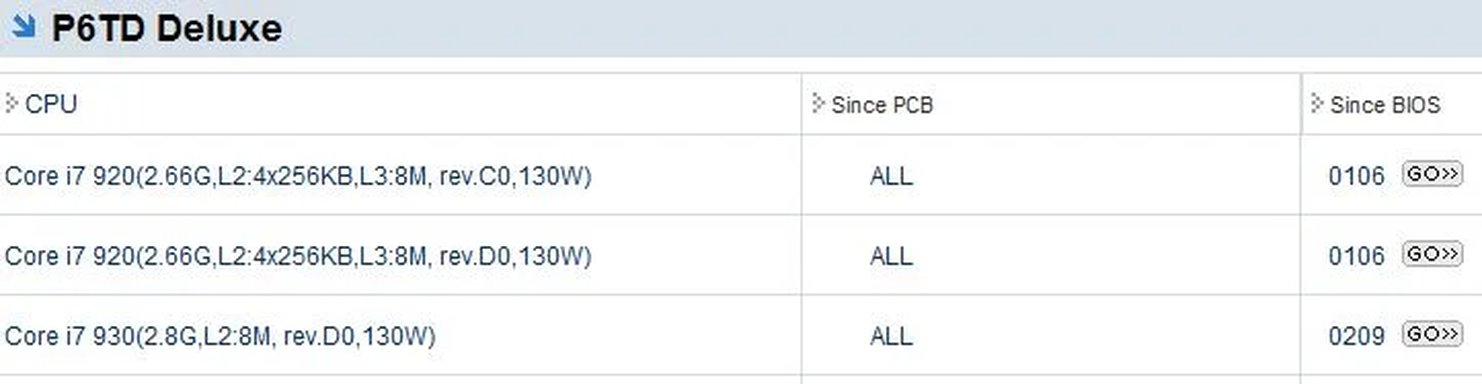

but i guess i didn't do enough background research on my components since I was one of the many who paired an ASUS P6TD v1 board with an Intel Core I7 930.
Please explain what you are talking about. As clearly shown on the ASUS CPU Support page, all versions of that motherboard support, with the BIOS noted, that CPU just fine.

It just seems that when I was looking on other forums, that I kept seeing people posting and complaining about system hang ups and freezes when they have paired the P6TD V1 and I7 930. I've also read that the 930 was not compatible with the v1 and only the 920 was stable with this version. And yes as soon as I got the motherboard I installed the BIOS update.
Where? Got a link?
The problem with looking on other forums is no poster is going to start a new thread to report this CPU works with that board. Happy people don't complain or start threads. And ASUS is a major, reputable motherboard maker, so if there were a problem with a particular CPU, it would not be listed on their compatibility chart.
...only the 920 was stable with this version.
Yeah, now that's nonsense. Do not take what one or two individuals say on a forum as the gospel. Now if a major review site like Toms Hardware, Anandtech, Hardware Zone, or Tweaktown said that in a real article or review, that would be different. That's like I don't put much stock in user reviews at Newegg either. Again, happy people don't complain. Now if there were 10 reviews and each one had the exact same complaint - then that would be a pattern to pay attention to.

I saw that link before - did you read through it? Two people in the whole wide world (that guy and you) having a problem with that CPU on that board does not even remotely suggest they are not compatible. Did you note what the ASUS moderator said, in red?
-you should link to some sort of proof of this rather than simply complaining and making wild accusations, otherwise you sound like a troll that's trying to stir up trouble
I am not suggesting you are trying to stir up trouble. I don't believe that for a second. I am just saying you need to be realistic. I provided 3 links where respected sites are selling that CPU and that motherboard as a bundled pair. Do you really think they would do that if not compatible? When asked for a link multiple times, that poster didn't have any - except to his own post, and another post that was a different CPU. Then others showed where they had the same combinations and no problems. And they provided a link to a respected site (bit-tech) that had conducted a very thorough review of that CPU using that same motherboard. They even tested that CPU's overclocking capabilities using that board and found it could run at an astonishing 4.3GHz with a standard air cooler! If there were any compatibility issues, they would have surfaced then for sure.
Is the i7 930 compatible with the ASUS P6TD? Absolutely! And there is plenty of proof!
