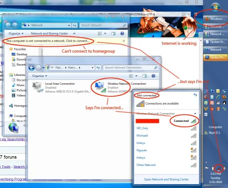

I've been Googling this problem for at least 2 hours and still haven't found a solution.
I've had this problem for a while now and I didn't really mind since I still have access to the internet. However, today I was trying to access my HomeGroup but it tells me that I'm not connected to the network.
I haven't installed anything. Just one day, I turned on the laptop and there the red x was. I haven't had any problems with Windows 7 aside from Firefox crashing all the time. I think it blue screened on me two or three times too.

tessa:
Hello and welcome to the forums. Nice collage, I can certainly see how you may be confused, I was, Just looking at it. What does the network and sharing center have to say. Is your network there private or public, make sure it's set to private. Run the trouble shooter or try the new network setup wizard. Do you have a third party software product managing your wireless connection? Sometimes, actually quite often, Windows 7 likes to manage it and some problems can occur if you have another piece of software trying to do the job instead. If so you might try uninstalling it. As far as the homegroup issue is concerned you may, perhaps want to leave it and attempt to re-construct the homegroup and see if that helps at all
