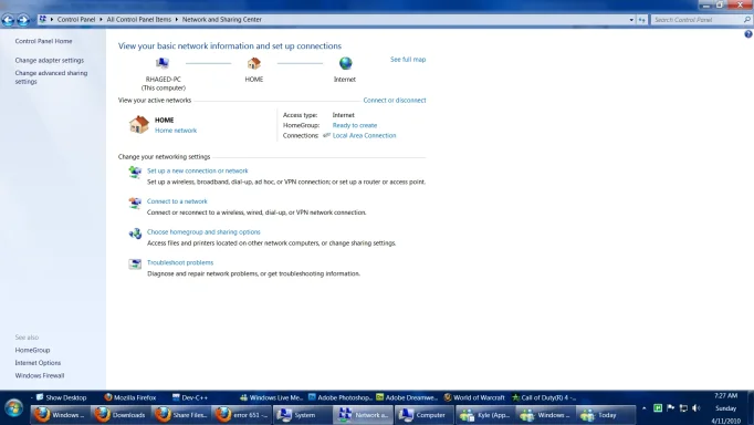

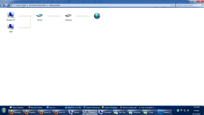

Screen shot of networking and sharing center.

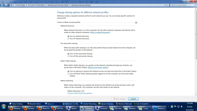

Current settings (Advanced)

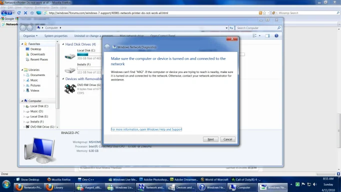

I can not click, view, or do anything to MX2

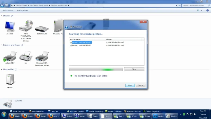

When I try add a Printer these come up on the list
Both seem to be the same. And its not even off the right network. (I think those are failed attempts to do printer sharing)

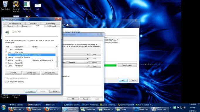

This is another thing thats driving me mad, There 2 ports one starts with 199, The other starts with PX32(Old computer A name). You cant remove them the error message is "The requested resource is in use"

This is not really my area, but when you look for the XP computer can you use the \\MX2 notation to connect to it?

Hope I did what you meant, Typed "\\MX2" Into a address bar and got.

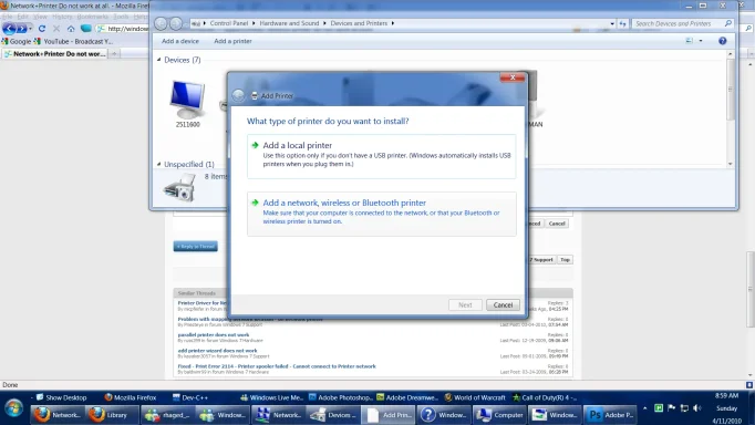

Yes that's what the print wizard gave me as a port name was the ip. It auto types it while i type the host/ip.
I would still like to be able to add my printer like this, It wont let me.

Do you see the computer in Explorer? I will assume not, so we need to get that taken care of. Does the XP computer have a firewall you might need to turn off? Does the router have some type of firewall?
Do you have any shares on the XP machine?. Are you using the same user name?
Are they both on the same local network addresses, like 192.168.1.xxx? If the router is doing DHCP, they should be.
The LLTD is only for XP, Vista and Win 7 do not need it.
I just set mine up. I did have to change the Network and Sharing center advanced sharing options to allow User accounts and passwords to connect as opposed to allowing Windows to handle it.
I then opened the network in Explorer. I could see the printer attached to the XP machine since I had shared it. There is an add printer option at the top of the window, which I used. Seemed to work fine, once you find the printer on your network.
