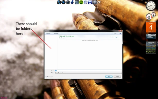

As stated my problem is that when I am trying to "Save As" or "Browse for" something - I have no folders on the left hand side - as one normally does.
In the first pic I'm trying to save as - using Firefox (it is the same with IE)

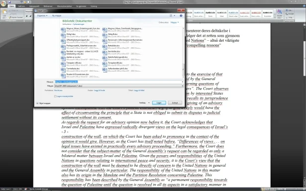

Same thing in MS Word:
The really weird thing is that sometimes it works - like the upload pic feature here works just like normal..

Do the folders show up ok if you start Windows Explorer from the taskbar?
If you try twice in a row, does it work better?
Well, a couple of more questions and then I will be doing more research.
If you right click in the navigation pane, do you get a context menu?
Have you run any third party software that might be related to the file system?
Have you tried closing and reopening the Navigation pane?
Have you moved any folders or libraries from their normal locations?

1. No
2. Not that I know of - at least not in any time near when the problem occurred
3. Not sure what you mean.. Do you mean tried pressing "Show / Hide folders"? - if yes - yes I hav; no result
4. Again, no not that I know of (at least not since installing W7)
Thank you for helping :)
1. No
