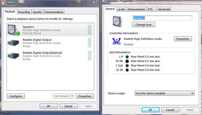

#6
If you right click on the speaker icon and select Playback Devices, do you get the same type of setup as the attachment?
Do you have a headset you could try?
