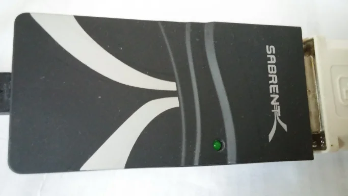

I have the sabrent 1612 usb product (DisplayLInk) which allows me to use a extra monitor via USB. Worked fine until windows 10. Now the monitor gives me a no signal .
What's more, I have trouble un-installing the program .
I have the windows 10 driver.....When I tried to update the software I get " the older version of displaylink core sortware cannot be removed" . Called the company support , horrible support.
