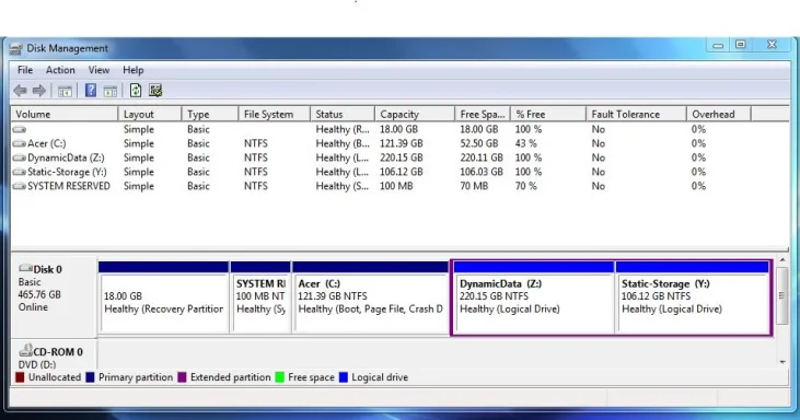

A snipping tool picture of your Disk Management Window, attached with the paper clip on Advanced Replies, might help us see the situation.

I don't have a screen grabber installed yet but for what's it's worth this is what I have so far.
Win7 Partitions existing when laptop purchased and created.
I assume that the 1st 2 (non-drive letter) segments are treated by most partition apps as actual partitions ? And for that matter they may very well be but have modified attributes by Win7 ? (i.e. no drv letter etc)
I assume this because when I had the 2 above said segments plus the active primary C drv and 1 extended partition Z drv, I then attempted to create another partition and my partition App baulked saying there were no more partitions available for the HD.
So it appeared it read the 2 win7 system non drive letter segments as actual partitions, thereby fulfilling the max of 4 partitions.
I was able however to dynamic resize the extended partition into another logical drv, which I did.
My HD as it is now (the 4th partition is an extended one with 2 logical drives Z and
Y).
18gb Recovery Partition | 100mb System Reserve Partition | C: Primary
Active | Z: DynamicData | Y: StaticStorage
Excuse my ignorance of not knowing bout the snipping tool, here is a snip for your viewing.

It looks fine. I would not worry about the 41 MB, it might be mostly housekeeping space for the partitions. I created some partitions and in Computer, they say .1 GB is in use on an empty drive. Other things like recycle bin space, or some other system files could also be adding to the number..
