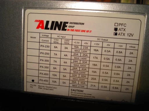

Usually a power problem, let's say a lack of power, only becomes apparent when the system is being pushed and pushed hard. Likely situations are gaming for example. If the system suddenly shuts down or blue screens during a game then the PSU could be a suspect. Do you know the actual output of the PSU? If you open up the case you might be able to see it written on the side of the psu. If it's something like 400W then you should be fine unless it's faulty..

800mhz ram will run at 667mhz on a 1333mhz FSB system. As for the PSU, 400 watt PSUs are ok for onboard video but are no good for any rig with a video card installed. Use an online power supply calculator to tell you what size PSU you require.....

I beg to differ, 400w might be fine for a low end solution but at the end of the day it's amps that's the important number here.

agree 100%. I was going to add in my response that buying name brand equipment and amps on the 12 volt rail are the main consideration in selecting a PSU but unfortunately IMHO experience has taught me that most folks are only aware of the big number stamped on the side of the unit. Selecting a higher wattage PSU usually guarantees they'll get a 12 volt amp sufficient unit.

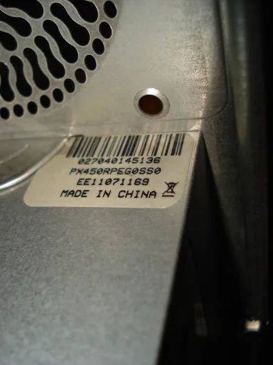

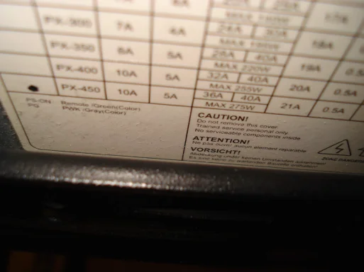

gabiibag
Well-Known Member
To the respective system i updated the BIOS to the newest stable one and i also put on the system 3 GB of RAM.
The same problem when shutting down.

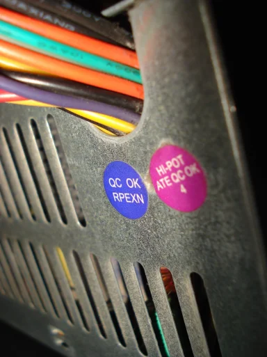

I opened the case and you can see in the pictures what is written on the PSU.
How many Watts has the PSU?

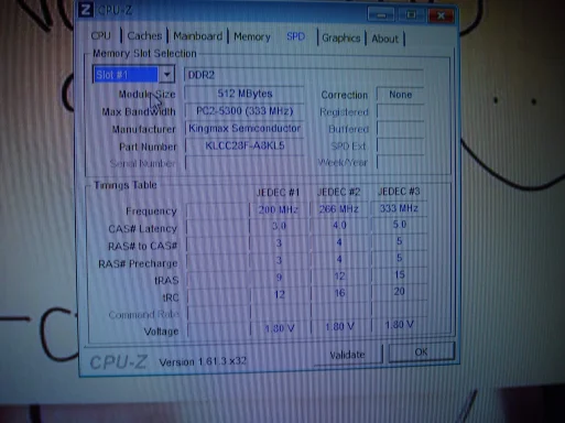

gabiibag
Well-Known Member

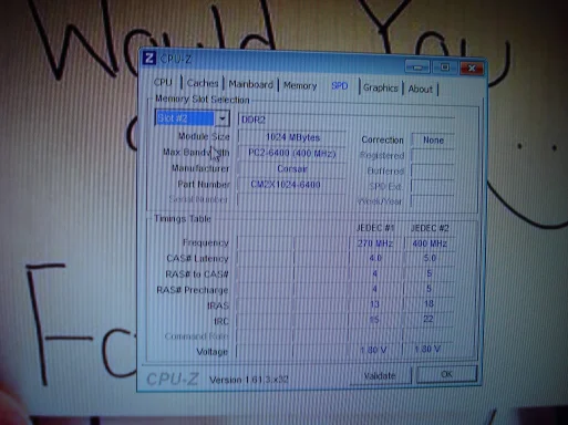

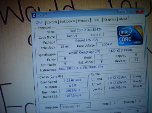

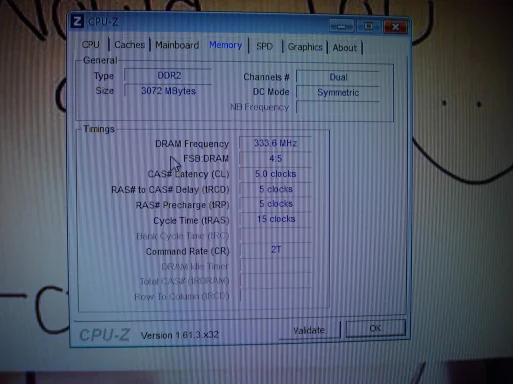

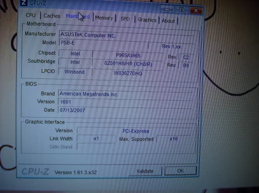

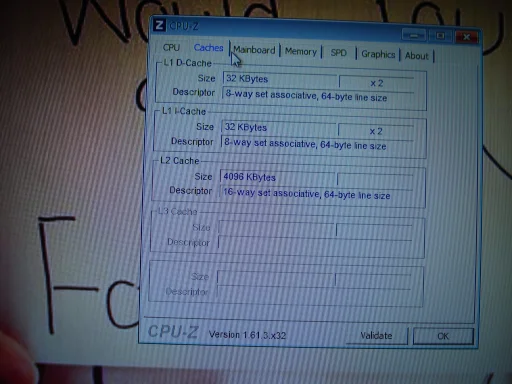

Also in the next pictures you can see the new configuration after installing 2x 1GB 800MHz.
The 4 RAMs are running in dual-channel at 667MHz?
