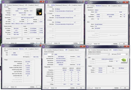

Hello guys,
I am novice in this field. I only have the .dmp file which i attached with this message. Could you please have a look at what might be the problem. I am using 32 bit Windows Ultimate.

Ok , the stop code indicates 124 , meaning that its a very high chance of hardware issues
can you download a program call CPUZ, print screen each tab on the program and upload them please ( only about 5 or 6 pics i think )
Also if you have overclocked ure pc please reset all settings to default

Hello again,
Many thanks for detailed reply. I now attached the print screen of each tab to a single file for your analyses. But i never overclocked my pc. I dont even know what it means really. How can I reset that settings to default?
