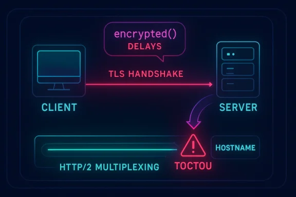

Neon diagram of a TLS handshake from client to server, showing encrypted() delays and a TOCTOU hostname warning.Background​

Qt’s network stack is built around asynchronous events. When a TLS handshake completes on a QSslSocket, the QNetworkAccessManager infrastructure emits an encrypted() signal (or equivalent callback) to indicate the session is now encrypted and suitable for decisions that depend on TLS state (peer certificate checks, hostname matching, HSTS handling, etc.). In many designs this signal is the canonical point where TLS-dependent validation and policy enforcement occur.
The bug here is classic time-of-check/time-of-use (TOCTOU): some parts of the HTTP/2 handling path would perform security-relevant checks or proceed to send application data before the code that relies on the encrypted() signal had actually run. The asynchronous nature of the signal and Qt’s internal handling of connections (including connection reuse and multiplexing under HTTP/2) meant that encrypted() was not a robust synchronization point in some code paths. In practice this allowed a sequence such as:
  • Client opens a TLS connection that will be or becomes HTTP/2-capable.
  • Server issues a redirect (or connection reuse causes an address mismatch) before the application-level code receives and processes encrypted().
  • Qt continues and sends data or follows the redirect without having enforced hostname/certificate checks for the redirected address, because the expected timing and ordering of events were not guaranteed.
Why HTTP/2 makes this worse​
HTTP/2’s multiplexing and connection semantics reduce the number of TCP/TLS connections used for multiple logical requests. That reuse is normally a performance benefit, but it also increases complexity:
  • Connections may be pre-established or reused across multiple logical requests to different targets.
  • Qt’s internal optimizations for HTTP/2 mean that the same physical connection may be used in ways that skip the usual “first connection => emit encrypted()” pattern.
  • Because the encrypted() signal is only guaranteed for the first connection to a host within a QNetworkAccessManager lifespan, logic that assumes receiving encrypted() for every request can be wrong.
The combination of these design choices produced a narrow but real window where security policy checks could be bypassed.
