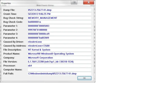

The last irony is that while I was using the wizard, there was a BSOD, and Bluescreenview's diagnosis labeled the problem as memory management. I really don't know how to deal with assessing BSODs very well, but it makes it appear that the problem was something other than physical RAM. Does the attachment mean anything specific to anyone else?
