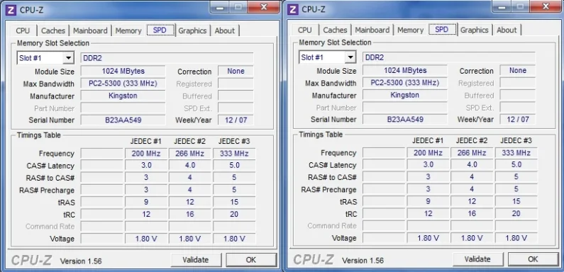

I've attached the CPU-Z screenshots. Also uninstalled Damon and SPTD. Thanks again.

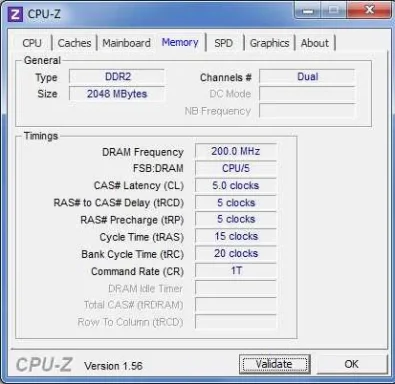

You didn't post the memory tab at all, but yep, you needed to remove DT/SPTD. So I can't say if your RAM is an issue yet or not.
Sure thing, you're welcome.
Looks good. It's underclocked in that screen shot but when you do something that needs computing power, it raises to its nominal frequency. Normal, standard operation and all is well. The machine should be fine now. Enjoy.
