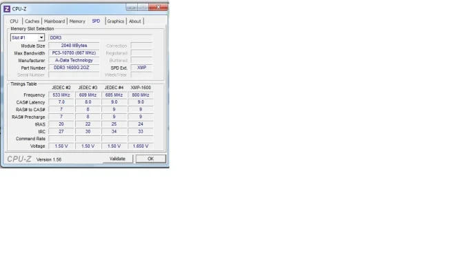

#6
spd.jpg Hey, here you go, thank you again.
#7
Thank you again, is this the driver I need for the realtek?
Win7 and WinServer 2008 R2 Auto Installation Program (SID:1432824)
Also, can you please repost the link for the motherboard one? I think I may have found the correct one on the EVGA site, but want to make sure.
Thank you again for all of your help.​
#8
Yep, EVGA site is the one. I didn't intend to post any link for that - it was a mistake.
Realtek is good.
You didn't post the memory tab of CPU-Z, so you can do that.
You're welcome.

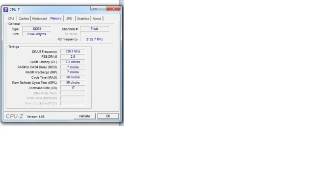

#9
oops, tooamny screens, I aplogize, here you go: ram.jpg
#10
Halt. Stop Houston. We've found your problem.
The memory frequency is way overclocked. It needs to be set at 667 MHz, instead of how you have it now at 730 MHz.
Go in the bios and make necessary change. Save. Enjoy.
(3:8 ratio should do that, fairly sure.)

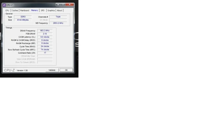

#11
Hello, thank you for your patience. Here is my latest memory tab after choosing the "load defualts" setting:
#12
Not good.
Timings have to 9-9-9-24 and the frequency has to be 667 MHz. Like I said, the FSB:RAM ratio probably needs to be 3:8 and not 2:8.
You have to set this up manually, save, boot to Windows and then run CPU-Z memory tab to check.
If not good, back to the drawing board and try again.
You're welcome.
#13
Hi, here is my latest attempt. I cannot figure out how to get the ratio you listed though, I must being doing something wrong :(
#14
Nope, not wrong. Looks good to me. :)

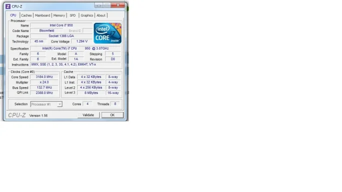

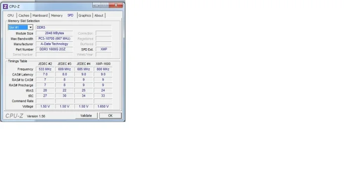

#15
Whew! Thank goodness! It looks like the processor is still at the same setting, which is bit overclocked still. Is that still ok or do I need to back it down to the original settings? I attached the CPU and Spd ones again to be sure.
#16
Nah, that overclock is very small. Nothing to worry about and it will not cause issues.
