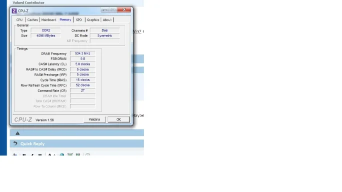

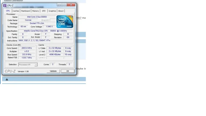

    RAM is the issue here, whether it be set unwell in the bios or simply defective.
    Please post a screen shot of CPU-Z spd tab and also one of memory tab so we can see if the bios needs adjustment or not.

    will post the cpu-z stuff. I did follow all the instructions......Maybe try 1,3,5 again? anyways will post that in 1 sec
  18. Deezul
    Deezul New Member
    Joined:
    Nov 14, 2010
    Messages:
    40
    Likes Received:
    0
    SPD Tab and memory tab
    [​IMG]
    [​IMG]
  19. Deezul
    Deezul New Member
    Joined:
    Nov 14, 2010
    Messages:
    40
    Likes Received:
    0
    Its Crucial Ballistix Tracer if that helps. 4x1GB

    Post the spd tab. (You posted the cpu tab instead by mistake.)
    That doesn't look right to me anyhow....so we can be sure if it is wrong when you post the spd....
    Memory set unwell in the bios is the likely issue here.
