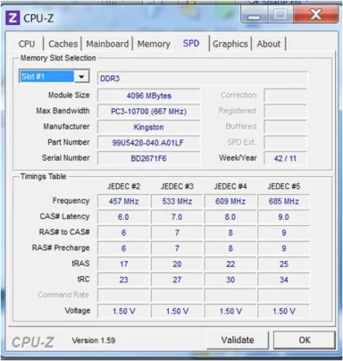

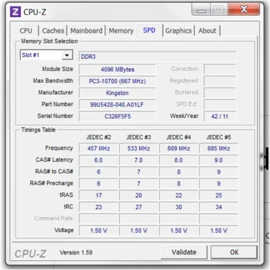

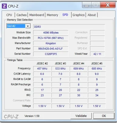

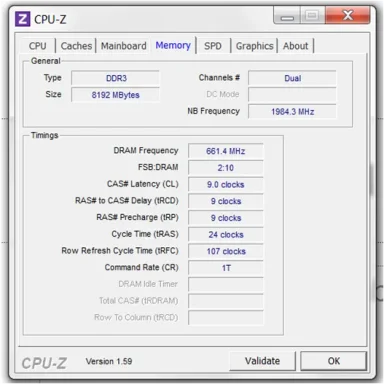

Can you confirm the missing ram from the SPD tabs screenshots matches the one you've shown? I.E. Same Manufacturer, Type, Model, Size, Batch, Timings, Etc.? Preferably bought as a matched set.
If it is then try changing the Command Rate in bios from 1T to 2T. See if that settles the pc down.

#8
If After All Of The Above you still get a bluescreen, then:
I don't understand what you'd like me to do here? i've done everything before this, except for the printer driver, because i still got blue screens before i installed the printer driver and I couldn't find a newer drive for the printer.
also I bought the Rams from the same shop at the same time, they came in two different boxes though.
Also attaching the latest Dump files.
Thanks a lot :)

#10
Okay so i took pictures of slot 1 and slot 2, I think that's what you wanted.
and I changed Ram to 2N with Tweaker, I think thats what I was supposed to do, its still crashed though, so now I do the Memtest? :)
