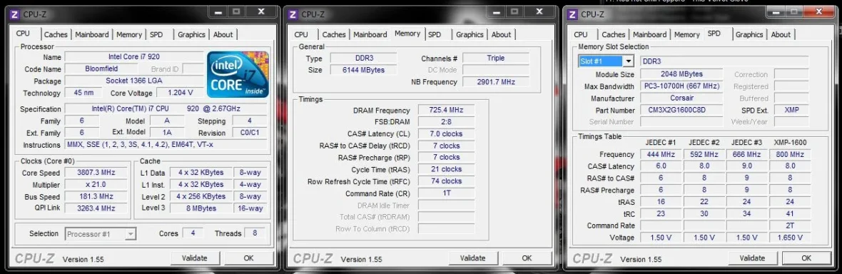

Hi All
I've been suffering from random BSOD's for a good while now (before I OC'd it, before you say anything :P) but they've recently gotten more and more common (1-3 in an evening), and it's getting a teensy bit annoying :P
It started getting worse after I went from Vista to 7/XP in August, and I rearranged the RAID at the time so I doubt there was any leftover files to screw anything up. Not long after, the RAID rearranged itself after a BSOD, going from one 250Gb volume and a 1.5Tb volume to 2 790Gb volumes. Both OS's boot and run fine, (apart from the BSODs lol), but the larger volume is inaccessible. I don't know if it makes any difference, but since the volume went I've been using my USB external hard drive for storage.
The BSODs are usually error code 50 or 01, but sometimes there is another one (I can't remember the code) with usbuhci.sys mentioned. They happen irrespective of what I'm doing so far as I can tell, but mostly occur after it's been on for a while.
I've attached everything the SF Diagnostic tool chucked out and screens of CPUz as well, and I think I've covered my system specs in my profile fairly comprehensively, sorry if I missed anything. Thanks in advance for any help :)

Your RAM settings are wrong, load bios with the optimized defaults and if it doesn't help then set the timings manually 9-9-9-24.
Also check the RAM sticks manual -.pdf or its package with the specs - to verify the timings, frequency, and the voltage.

Cheers for the reply :)
My RAM is rated at 8-8-8-24 at 1600MHz on 1.65v. I set it up like it that cos I figured if I was underclocking it then it might run tighter timings, but it was a bit of a blag... I can't load the optimised defaults for just the RAM in the BIOS, so I've manually adjusted the timings, time will tell if it helps.
As for the drivers, I tried to use the most up to date drivers when I rebuilt it a few months ago, I don't know how stuff from 2007 got in there lol
Is there a way to view a list of drivers and choose which ones to update? I can update the software if I know where it is, but things like the Adaptec RAID driver, I can't even find it in the device manager, and I don't know what it's used in so I can't download updates
Adaptec is part of your motherboard, so you may find an update in the downloads.
Most of the error codes are due to the faulty drivers or incompatible drivers. If the stop message displays any of the driver names, then roll back that driver or replace the faulty driver with a new one. Up-gradation of drivers also could solve the problem.
For more info, visit Link Removed - Invalid URL
