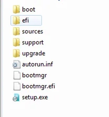

in terms of my recovery disk files, HP split them into two disks. here are the contents.
ok that is different from a full 7 disk. My Dell upgrade disk is identical to a full 7 disk minus 1 file ei.cfg in sources folder that tell's what version it will install and the Channel is OEM.
I am not sure your disks will support a full install. is missing some things
