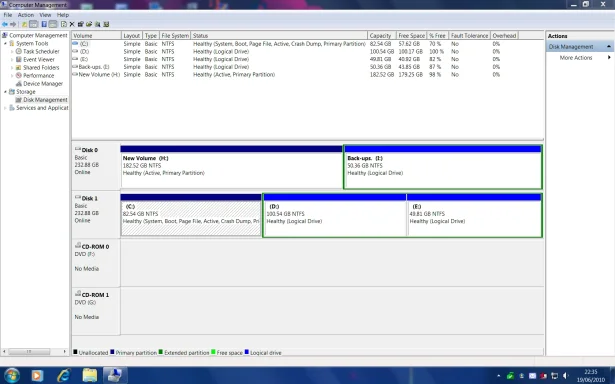

If you could use the snipping tool to take a picture of your Disk Management window and attach using the paper clip, it would be very helpful.

Don't know if you will be able to see it this way, the thing to notice is that "C" partition is now on SATA1 whereas before it was on "0" and if I return it to there it won't boot.

The drive number is controlled by the SATA connectors. The Drive Order is determined in the bios. Since you only have one active partition, your system should boot no matter which drive it is. Unless there is an issue with the logical drives which I will try to check out.
Having two of the same size hard drives might make it harder to determine which drive is which and it seems different bios routines handle that differently. But there should be something that differentiates them when setting an order. Maybe if the wrong drive is set to primary, it is also set in the boot order the other drive is not seen by the boot.
I have seen nothing to indicate why adding a TV card would mess up your boot. Maybe powering the system down was involved.
Do you have a reason why you have all the logical partitions? I know Win 7 will not do that unless you are adding a 4th partition with space still left on the drive.

I did not notice, but your XP drive also has an active partition. If it is encountered first during the boot, you will get the Bootmgr message or some other error, unless you have valid boot files in that partition.
My comments about the logical drives is not a critisim, but an observation that Win 7 could not have set it up that way. You must have had a previous install or used another utility to set up the partitions. The fact you tried the recovery DVD may account for the two active partitions, but only you would know your exact situation.
