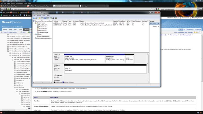

    Ok, here's a picture of the Drives, not too sure of what's going on here >.<
    Thanks again

    The 1GB partition isn't actually partitioned yet. You can partition and format from the right click menu. Did scan send the machine out like that?

    Well if it was me, I'd repartition and start again with a reinstall, could even solve your freezing problem with FF. I'd always thought scan were a decent company. Sending a machine out with a HDD unpartitioned is unforgivable. Just a thought delete the E: Part and then right click on the c: part and resize it to fill the ssd.

    Please do not delete nor otherwise mess with the E partition on Disk 0 as it is plainly marked in the disk management utility as "System" and "Active" and doing so will in all probability hose your install, and will propably require some serious repair efforts that may or may not be successful.
    It would seem that your OP indicates an issue with the 1TB drive, Disk 1 (931.51 GB available), which it sounds like you have already managed to format and should be showing up now as useable space both in Disk Management as well as Explorer (with the next available drive letter.

    D*mn I missed that. Really wouldn't expect that layout. Definitely do not remove that partition.

    Good call Trouble, however, he would not be able to delete that E: partition even if he tried, Windows or any 3rd party partitioning tool would not let him delete it as it is a "System" drive/partition, as you caught. [​IMG]
    It does seem very strange that they would put a "System Reserve" partition after the OS and to leave 11Gb's at the end of the drive and a 1Tb drive unallocated. [​IMG]

    OK, if you say so, but I can pretty much guarantee, that if I boot to my Acronis Disk Director Suite CD, I can pretty much do anything I want to do with my HDs and partitions, not even sure that I would get a warning. And the 11 GBs at the end of Disk 0 is actually only 11 MBs, according to what I'm seeing.
