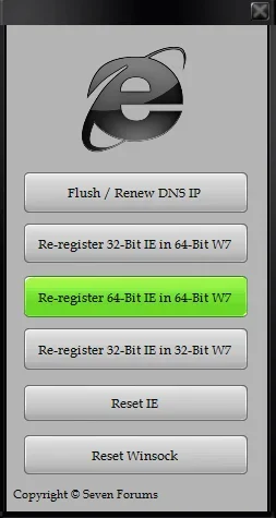

ScreenshotThis is small utility i created for Troubleshooting Internet Explorer issues. It will Flush DNS, Re-register concern dlls for Internet Explorer (3 different types 64-Bit, 32 Bit on 64-Bit OS and 32-Bit) Reset IE to Default settings, Reset Winsock.
SF IE Restorator will work with Internet Explorer 8 on Windows 7. It will work with other operating system only if you have .NET Frameworks 3.5 installed .
