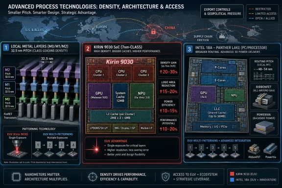

Technology infographic comparing Kirin 9030, Intel 18A, and process features with global supply-chain context.A Smaller Metal Pitch Is Not a Process Victory​
The headline comparison is simple enough: SMIC N+3 shows a 32.5 nm M0 pitch, while Intel’s shipping Panther Lake implementation on 18A is said to use 36 nm. M0 is a very low-level local metal layer, used inside the standard-cell neighborhood rather than as a broad measure of chip-wide interconnect quality. Treating it as a node scoreboard is like judging a city’s transit system by the width of one alley.
Intel 18A is not trying to win every front-side metal-pitch beauty contest. Its big architectural moves are RibbonFET gate-all-around transistors and PowerVia backside power delivery, both of which change how power and signal routing are balanced across the stack. If power routing moves to the backside, the front-side metal system can be optimized differently; a looser pitch in a shipping high-performance library does not mean the node is less advanced in any meaningful full-stack sense.
SMIC’s tighter M0 is impressive for another reason: it appears to be achieved without EUV, through aggressive DUV multi-patterning. That is an engineering achievement, but also a warning label. The tighter the pitch under immersion lithography, the more the fab depends on repeated patterning steps, tighter overlay control, more masks, more process steps, and more opportunities for variation to creep in.
This is why the SemiAnalysis framing is useful. The teardown does not say the 32.5 nm number is fake. It says the number is incomplete. In modern chipmaking, the question is not whether one layer can be pushed smaller; it is whether the whole system of transistors, wires, vias, libraries, SRAM, yield, cost, and voltage-frequency behavior produces competitive silicon at scale.
