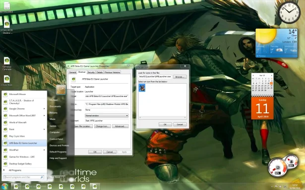

also when i try to change the icon by going into propoties it dosent show that the program is any differnt exsept for the icon. i can choose to change the icon but when i apply it dosent do anything.
Untitled.webpthis is a picture of my desktop see if this help at all it also shows a program which i looked at the prop
Can you do a restore back before you started having problems?
If not, try resetting all the default programs, assuming it works. Try right clicking on the Paint entry and see if it looks like the attachment
