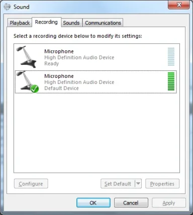

If you right click on the speaker icon and select recording devices, does the microphone show up? There should be a level meter on the right of the window, is it moving? Depending on the type of computer, ports can be changed depending on what might be plugged in or a front or back microphone input could be turned off.
If the microphone is listed in the Recording window, select it and look at properties for any appropriate options.
If you feel posting a picture of your situation might be helpful, you can use the snipping tool to take a picture and then attach it using the paperclip.

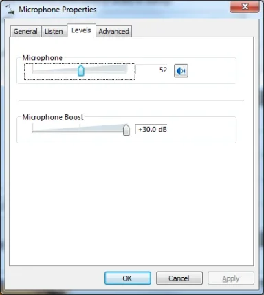

The microphone I use is the second in the row. As seen by the picture the level meter is changing when I speak.
The second picture is tho show that the microphone boost is set to max.
However, I still cannot record anything :(

You might try raising the level and not just the boost.

I raised the level to 100% the boost too.
