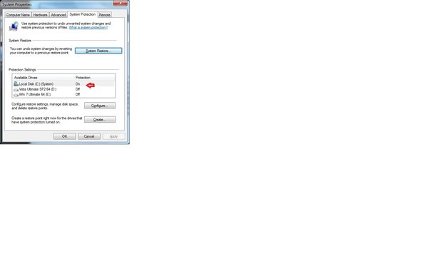

    You haven't mentioned this so forgive me if I am being simplistic. You have to have system protection on to create restor points automatically.
