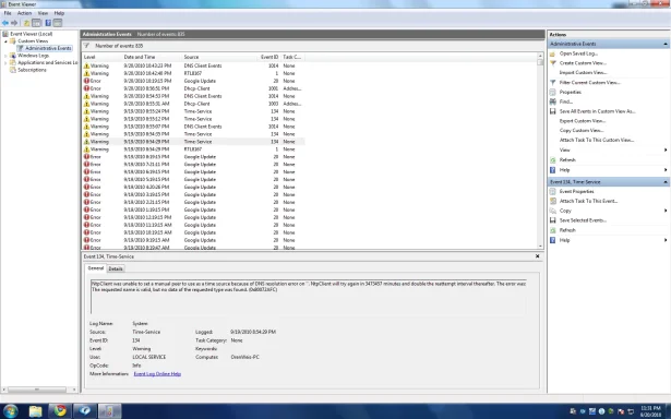

I also just attached a pic of my Event Viewer. It seems there are a lot of problems in there.....
Hope this helps.
Mike

Ok, I disabled my homegroup. I hope it works. Did any of those event ID numbers from the screenshot mean anything to you? Is this a very common issue when creating homegroups? Sorry for all the questions, but this has been driving me nuts!

It is only commonly posted on the Internet and there is no real way to judge. I would imagine half of Windows users haven't even bothered to use the feature and most that do never experience issues. The screenshot shows issues with DNS and DHCP which are consistent with the problem you are experiencing. To get it to work properly with your set up, for reasons unknown, you probably need to configure your network settings on each computer manually.

On the off chance your router is using 192.168.1.0 or some other number I can't give you that info.. so a lot of this is conjecture. But you would go into Network Adapters and set this on every NIC with a different Computer IP, creating a static IP network and then trying HomeGroup again. This would be needed if the DHCP server is giving out the wrong info for DNS. The screenshot is a bit useful, but its not giving me all the data I need. I would actually need to be tied into your systems to get a better idea of what is going on.
