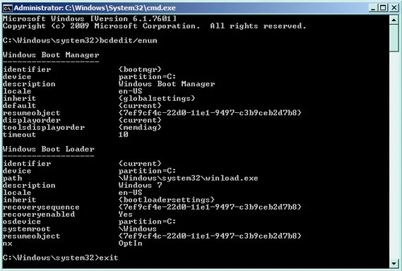

in MS-DOS command: bcdedit/enum I found
"Boot Manager"
resumeobject {7ef9cf4c-22dØ-11e1-9497-c3b9ceb2d7b8}
"BOOT Loader"
recoverysequence {7ef9cf4e-22dØ-11e1-9497-c3b9ceb2d7b8}
(note the difference it's only the " e " in 7ef9cf4e instead of 7ef9cf4c)
Which is the XP identifier to delete?
Please advise. Thanks! :)

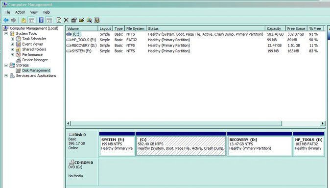

But Mike is right about being careful. A snipping tool picture of your disk management window might help make things clear. Attach it using the paperclip in the Advanced replies.

I send a snip of the "Aministrator...CMD.exe" and of the "Disk Management"

#6
Hi
I would still look at the boot file in EasyBCD.
It should look like this, if it shows an entry for Windows XP, it's safe to tell it to delete it as long as your computer boots into Windows 7.
Then it will no longer ask you when you start the computer and it will be safe to delete the old Windows XP folder.
I've never had any problems using this software, as long as you know you are deleting the correct OS.
Since one is Windows 7 and one is XP it should be obvious.

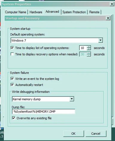

I follow the link you gave me "what happened to the boot.ini file?" and I send here two snips of the 'Startup and Recovery' (here, dropping the menu on 'Default oper. system' Windows 7 it is shown twice) and 'Environment Variable'. Can I change something here?
