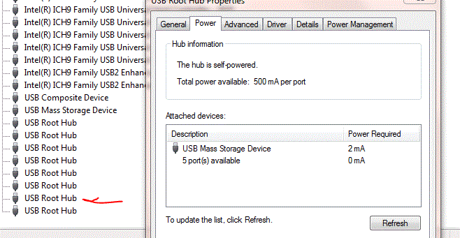

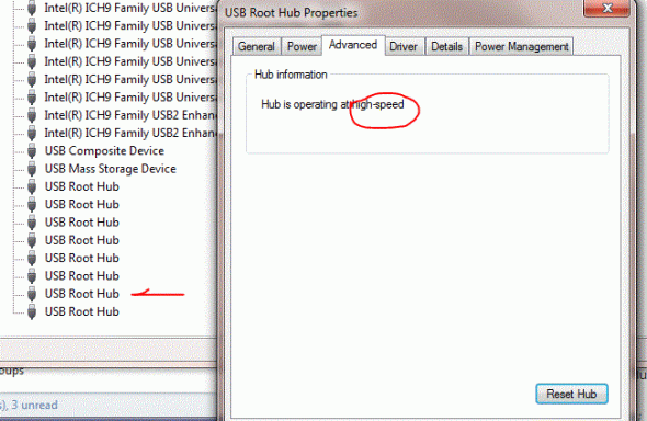

Both of my systems show the same as yours, so I will assume this is normal. If you open device manager and look through the USB controllers and hubs you may notice certain things. One is the USB 2.0 uses a 20% bandwidth and the 1.1 seems to use 10%. They can say full-speed or high-speed. The Advanced Tab has quite a bit of this info and the Details tab can be used to see what device is connected by using the "Bus reported Name" (if available) from the Property drop down menu.
I do not know how the controller sets up the ports, but if you have a device you know is 2.0, you might try plugging it into different USB ports and then checking to see where it is in Device Manager and see what it is running as.

On my two systems, with different chipsets, I show 8 host controllers with 2 of those being enhanced.
I also show 8 Root hubs with 2 of those being High Speed.
The full speed hubs show 2 ports available. The High Speed hubs show 6 ports available.
Two bottom 2 Root Hubs seem to the the high speed ones on both of my systems.
You can see from the attachments how mine seem to show up. Yours probably do also. If the device you seem to be having problems with shows it is on a high speed hub, we may need to look at something else, or see if removing some of the other devices on that hub might help.

2 Bottom Root hubs on mine also seem to be high speed. It's showing 6 available ports for each of them. I switched around way my devices are plugged in to idenfiy them...no luck...when I go to "properties", it doesn't show anything as plugged in, for the bottom two USB hubs
So here's what I did... I opened up all the USB Hubs in the device manager (there were 8 of them), in the order that they appeared in the list. For some reason, the high-speed ports are now 3 and 4, while the others are "full speed"
