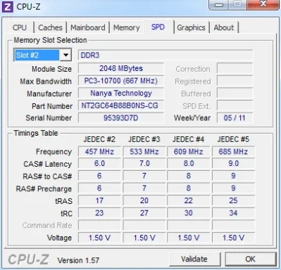

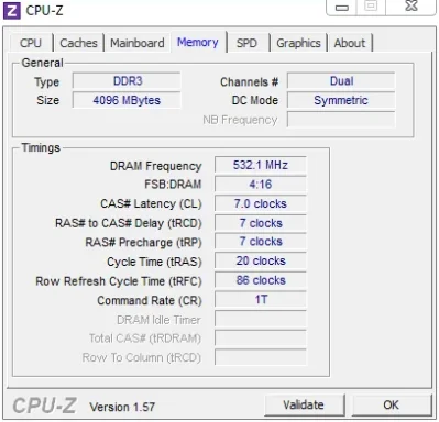

Hi,
I am currently having some problems with BSoD appearing while I'm browsing local network shares on our company servers through F5 Firepass vpn. It seems to come at random when you are viewing/editing office documents, but you can force the same bsod by searching for ppt etc on a network disk and just scroll down the page.
It seems for now that it is only affecting our Dell laptops, especially the Latitude E6410 but other models are affected too. Ive tried a few different Win 7 pro x64 images, the latest being with sp1 included. I did some tests with a Lenovo Thinkpad T60 and it stopped getting bsod after I installed Win 7 with sp1 included.
Give me a shout if you need any more information.
Thanks for all your help in advance.
