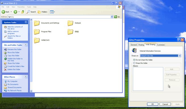

Hi,
In Windows XP there is option of Web sharing on right clicking on specific folder. How can we make web sharing in windows 7 OS ?

If you have IIS installed in your copy of XP, a context menu choice called "Sharing & Security" will bring you to a dialog that provides a tab called "Web Sharing" (in addition to the regular "Sharing" tab). This tab allows you to quickly create a virtual directory in IIS for the one that you've right clicked on.

By the way, the simple answer is that in Windows 7, the Windows Explorer Shell does not have the Web Sharing extention. You must go into IIS via Computer Management and mark the directory as virtual through the IIS Admin tool.

in case you're still wondering about this feature apparently it was removed since windows vista:
List of features removed in Windows Vista - Wikipedia, the free encyclopedia
"Support for enabling a folder for web sharing with Internet Information Services via the Windows Explorer interface was removed."
same as you i was using this in windows xp and find it quite annoying to have it removed...
