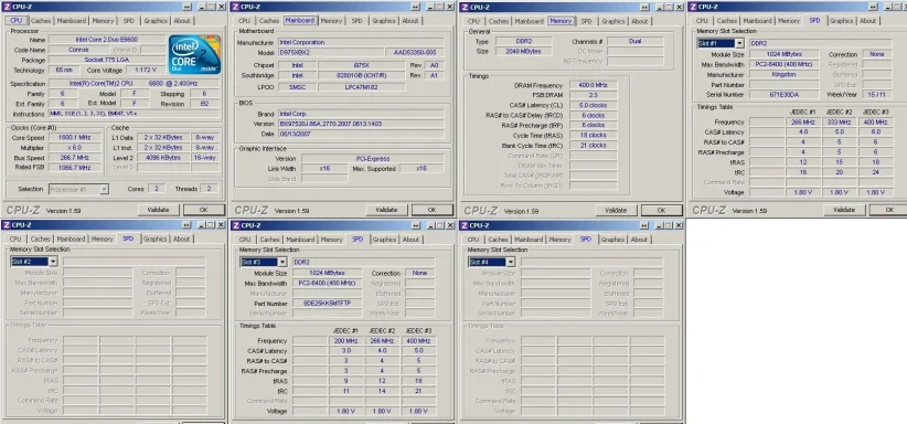

Download and run CPU-Z. Take screenshots**/snips of the CPU tab, Mainboard tab, Memory tab and all the slot #'s under the SPD tab.
Go to Post Reply, click on the Go Advanced button and attach the screenshots**/snips to your post for all the RAM experts to see by using the paper clip you will find on the top toolbar. Do not zip them up.

Alright guys. Btw, being new here, this place seems really well managed so thumb up and bro fist for that.Also enabled ads for the site.I got this computer from my brother several years back, and added my hard drive, and replaced a bad memory stick, so its self built in a way.Didn't realize I'd need such a comprehensive analysis, so I'll say this - I hate to hear like a bad case of 'Tales from IT', but there was a SATA driver problem for forever on devmgmt, but it never seemed to make a difference.I've also suspected this to be a loose power cable, but everything is in place.

I'd seriously think about updating your 2007 bios to the latest available (even though it will say vista). There's also your mismatched ram to think about............

ATM, I've changed memory to matching sticks, it's 5/5/5/18/21 now. I've also updates the bios. The machine was on it's side so it wouldn't crash during uPdate. Now that it's done I guess I'll test it standing. If it won't work has to be a cable /undercarriage / physical right?
