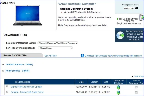

Mitchell thanks for the reply, as I am not on the SONY, I do have the attached information. It is a SigmaTel chipset. I have downloaded all the driver updates for Video and Sound with no results. SigmaTel is manufacture specific. sony1.JPG
I will look at the SONY when I am home.
Thanks again,
jorge

Alright, have you also checked for the latest chipset drivers?
#5
I have on the SONY site as there is not a SigmaTel location.
Thanks
