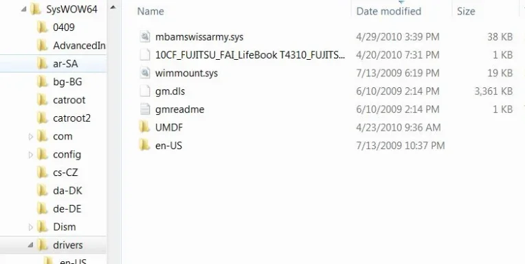

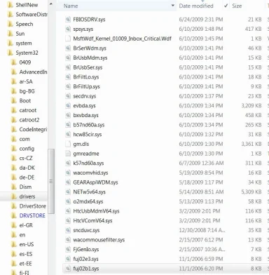

    Here's what you can do. Navigate to C:\Windows\System32\drivers and then sort the contents by Date modified order. Take a screen shot using the snipping tool of all the drivers from before July 2009. Attach that screenshot to a post and I'll tell you what the issues are.
    If you're using 64 bit, then do the same for C:\Windows\SysWow64\drivers in addition.
    Sort the files in C:\Windows\System32 as well, by type. If there are any .sys files in there, include that information as well.

    sys32driver.JPG syswow.JPG I hope you can read this. In all fairness, if the solution is really that simple, MS could have resolved this 3 months ago. Instead, they keep saying they are sending me a disc, then they close my SR without going through this process?

    It's not their responsibility nor problem when users load old drivers and old incompatible software. I don't see any problems there but you also didn't post the other info I asked for, where old drivers would likely be.
