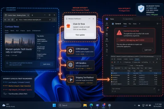

Diagram shows Windows integrity trust boundaries with a spoofed update warning and risky remote-debugging exploit.The Sandbox Boundary Failed at the Edges, Not the Wall​
Windows Mandatory Integrity Control is supposed to make compromise less catastrophic by dividing processes under the same user account into different trust levels. A low-integrity browser renderer, document viewer, or sandboxed helper can still execute code, but it should not be able to scribble across the user profile or launch meaningful activity as if it were a normal desktop app. That design accepts that bugs happen and tries to contain the blast radius.
Click Or Trick is uncomfortable because it did not smash through that boundary in the cinematic sense. It walked around it by persuading other Windows components to do ordinary things in the wrong order. The low-integrity process did not need administrator rights; it needed a path to make medium-integrity components act on its behalf.
That distinction is crucial for Windows administrators. A sandbox escape is often imagined as a single technical flaw that can be patched and forgotten. This one looks more like a supply-chain problem inside the operating system: too many privileged or semi-privileged components trusting that the previous layer already made the right decision.
The result was a practical escalation from restricted code to arbitrary write and higher-integrity execution after a user clicked a spoofed notification. That click is not incidental. It is the small piece of human participation that lets a chain of otherwise normal Windows behaviors become an exploit.

Toast Notifications Were the Social Engineering Layer Windows Supplied​
The exploit’s user-facing trick was a toast notification. SafeBreach found a COM object tied to Windows edition upgrade functionality and identified a ShowToast function that could generate notifications on behalf of other applications. The researchers could also control a launch command appended when the user clicked the toast.
That is a nasty primitive because toast notifications occupy a privileged psychological position on Windows. Users are accustomed to seeing them as operating-system-mediated prompts rather than random web pop-ups. They appear in the corner of the desktop, inherit app identity cues, and often ask for exactly the kind of casual click that users have been trained to perform without deep inspection.
The vulnerability name, Click Or Trick, is apt. The click is not a phishing page in a browser or a macro warning in an Office document. It is a click inside a native Windows notification path, generated through built-in mechanisms and attached to trusted application identities.
This creates a detection problem as much as an exploitation problem. Security tools are better at flagging unsigned payloads, suspicious script interpreters, and obvious process injection than they are at judging whether a toast notification was too persuasive. When the launch path begins with Windows components doing Windows-looking things, the first suspicious artifact may appear late in the chain.
The bigger lesson is that user interaction is no longer a clean boundary between harmless and dangerous. “Requires a click” used to imply a meaningful mitigation. In a modern desktop full of notifications, deep links, URI handlers, and app-to-app handoffs, one click can authorize a surprisingly long chain of side effects.

Teams and Chromium Supplied the Sharp Edge​
The target they settled on was Microsoft Teams. The desktop client is Chromium-based, and according to the research, it still exposed the Chromium --remote-debugging-port switch. That switch starts a Chrome DevTools Protocol server on a local port, a powerful interface intended for debugging but dangerous when exposed in the wrong context.
The chain used a crafted Teams URI passed through Snipping Tool’s redirect mechanism to inject the remote debugging switch. Once Teams opened with remote debugging enabled, the researchers could talk to the DevTools Protocol server locally. From there, they used protocol commands to change the download directory and download a file outside the sandbox.
That produced the arbitrary write primitive. In sandbox escape terms, arbitrary write is one of the milestones that changes a clever demo into a serious vulnerability. If sandboxed code can cause a medium-integrity app to write attacker-controlled content into locations the sandbox itself cannot access, containment has failed.
Again, Teams was not necessarily “the vulnerability” in isolation. Chromium’s remote debugging feature is legitimate in development and test contexts. Teams’ URI handling exists for deep links and collaboration workflows. Snipping Tool’s redirect behavior has documented uses. The exploit emerged because each component assumed the others had reduced the risk.
This is the heart of the story: Windows is no longer just an operating system in the old kernel-and-shell sense. It is an ecosystem of bundled apps, cloud-connected clients, protocol handlers, notification brokers, package managers, identity surfaces, and compatibility layers. Every one of those pieces may be defensible alone. Together, they can form an attack graph.

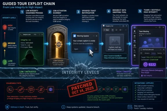

SafeBreach Labs disclosed that Windows 11 contained a sandbox escape flaw, tracked as CVE-2025-59199 and patched by Microsoft on October 14, 2025, that let a low-integrity process break out through a spoofed notification click and chained Windows components. The important part is not that one obscure interface misbehaved. It is that the exploit path looked less like a smash-and-grab and more like a guided tour through modern Windows. Click Or Trick is a case study in how convenience features become security boundaries by accident, and then fail under pressure.
Infographic showing a “Guided Tour Exploit Chain” for Windows COM activation leading to spoofed toast and Teams/DevTools hijacking.Microsoft’s Sandbox Boundary Was Beaten by Its Own Plumbing​

The First Crack Was Not Code Execution, but Integrity Confusion​
The researchers started where many Windows escape stories start: COM. Component Object Model is old, sprawling, and deeply embedded in the operating system. It is also a tempting attack surface because COM is designed to let one piece of software ask another piece of software to perform work, sometimes across process and privilege boundaries.
The key distinction in this case was between in-process COM servers and out-of-process COM servers. An in-process server is loaded into the caller’s process, so it generally inherits the caller’s security limits. A LocalServer32 COM server, by contrast, runs as a separate process, creating room for surprising differences between the caller’s integrity level and the server’s.
SafeBreach focused on COM objects that low-integrity code could still activate. That is not automatically a bug. Sandboxed software needs ways to talk to brokers, system services, and user-interface helpers. The problem appears when the brokered component carries more authority than the sandbox should be able to command.
The researchers found an AppID associated with Windows edition upgrade functionality that used an undocumented flag allowing the COM server to launch with the user’s unmodified logon token. In practice, that meant a low-integrity caller could trigger a medium-integrity process under the same user account. That was not yet a complete exploit, but it was the essential crossing of the line.
This is the kind of flaw that illustrates the difference between user identity and trust. Windows knew the process belonged to the same user, but the whole point of integrity levels is that not all processes under the same user should be treated equally. Once a low-integrity process can summon a medium-integrity helper and influence its actions, the sandbox boundary starts depending on every downstream parser, launcher, and app association in the chain.
The Notification Became the Attack Surface​
The next step was the part that gives Click Or Trick its name. The COM object exposed a ShowToast function, and the researchers found they could use it to generate Windows toast notifications that appeared to come from other applications. More importantly, they could influence the launch command attached to the notification click.
That changes the user interaction model in a subtle but serious way. Many security prompts are built around the idea that a click represents consent. But a toast notification is not a consent dialog in the way a UAC prompt is supposed to be. It is ambient interface furniture, the kind of thing users dismiss or open reflexively.
The exploit did not require the target to approve an administrator elevation prompt. It required a click on a notification that could be dressed up as something ordinary. That matters because the history of desktop security is full of boundaries that technically depend on user interaction but practically collapse when the interaction is mundane, spoofable, or divorced from the actual consequence.

Snipping Tool Was the Detour That Made the Chain Work​
SafeBreach found that Snipping Tool could be launched with URI parameters and that its documented discovery flow included a redirect-uri argument. That redirect behavior allowed the researchers to pivot from the spoofed notification into Snipping Tool and then onward to another registered URI handler chosen by the attacker.
This is where the chain becomes distinctively modern. The exploit did not rely on a single component doing something obviously catastrophic. Instead, each component performed a behavior that could be explained in isolation: a COM server launched, a notification opened an app, a URI handler accepted parameters, a tool redirected to another URI target. The weakness lived in the composition.
The team first explored file-based URI targets. Low-integrity processes have limited write access, but LocalLow is one of the places they can use. Interpreted files such as scripts could be launched under some conditions, but native executables and batch files ran into file association checks that blocked the cleaner path.
That partial failure is important. Windows did stop some obvious abuse. The problem was that the ecosystem still offered another route, because the operating system is not a single gate; it is a city of interconnected side streets. If one route rejects a file association, another URI handler may still accept attacker-controlled parameters.
The researchers eventually settled on Microsoft Teams. The desktop client’s Chromium foundation exposed the Chromium remote debugging switch, allowing a local Chrome DevTools Protocol server to be started on a chosen port. By passing a crafted ms-teams URI through the Snipping Tool redirect path, the researchers could inject that switch and open a powerful debugging interface in a medium-integrity application.
Teams Turned a Click Into an Arbitrary Write Primitive​
The Teams leg of the chain is a reminder that Electron and Chromium-based desktop apps inherit not only web-platform convenience but also browser-grade developer machinery. The Chrome DevTools Protocol is enormously useful for debugging. In the wrong context, exposed on the wrong port, with the wrong assumptions about who can start it, it becomes a control plane.
Once Teams launched with remote debugging enabled, SafeBreach used DevTools Protocol commands to change the download directory and download a file outside the low-integrity sandbox. That created an arbitrary write primitive, which is often the point where a sandbox escape stops being theoretical and starts becoming operationally meaningful.
Arbitrary write is not automatically total compromise, but it is a major escalation from low-integrity confinement. It can allow an attacker to place files where the sandboxed process could not normally write them, stage follow-on execution, tamper with user-accessible locations, or combine the primitive with other weaknesses. In real attack chains, this is precisely the kind of foothold that turns a renderer compromise into a broader desktop compromise.

User Interaction Is a Weak Defense When the Click Is Ordinary​
One reason this vulnerability will resonate with attackers and defenders is the single-click requirement. Security scoring systems sometimes treat user interaction as a mitigating factor, and in many cases that is fair. A remote unauthenticated exploit is obviously worse than a bug requiring a local user to do something.
But not all user interaction is equal. Asking a user to run an unknown executable is different from asking them to click a notification. Asking them to approve a UAC dialog is different from presenting what appears to be a routine app toast. The more ordinary the action, the weaker the practical mitigation.
Modern desktop environments train users to trust notifications as part of workflow. Calendar alerts, Teams messages, screenshot prompts, OneDrive nags, update reminders, and browser notifications all compete for attention. A spoofed or misleading toast is operating in an environment already optimized for reflex.
That does not mean user education is useless. It means user education cannot carry this class of risk alone. The platform must assume that a low-integrity process can sometimes obtain a click. If that click can be converted into a medium-integrity launch with attacker-controlled parameters, the sandbox is depending on behavior that attackers are good at manipulating.
The better security question is not “Would a careful user click?” It is “What is the maximum authority granted after the most boring plausible click?” Click Or Trick suggests that, before the October fix, the answer was too much.

The Real Exploit Was the Chain​
Click Or Trick is valuable research because it resists the comforting simplicity of a one-line root cause. Yes, Microsoft assigned a CVE. Yes, there was a patch. Yes, the vulnerable behavior can be described as improper access control. But the exploit’s power came from chaining ordinary mechanisms until the operating system lost track of the original trust boundary.
That should sound familiar to anyone who has watched Windows security evolve over the last decade. The most interesting attacks increasingly live in seams: Office automation into script engines, browser renderers into brokers, identity tokens into cloud sessions, update tools into local privilege, and now notifications into URI handlers into Chromium debugging. The seams are where product assumptions meet attacker patience.
The irony is that Windows has many of the right primitives. Integrity levels are a real boundary. COM launch permissions can be constrained. App identity can help route experiences. URI schemes can support safer app integration. Notifications can improve usability. DevTools can enable legitimate debugging. The problem is not that these mechanisms are inherently reckless; it is that their combined behavior can exceed the security model any one team intended.
That is why research like this matters even after the specific CVE is patched. It gives defenders a map of how attackers think about platforms: not as a list of isolated features, but as a graph of transitions. Every transition asks a question. Can this low-trust process cause a higher-trust process to start? Can it influence parameters? Can it redirect? Can it select a handler? Can it reach a debugging interface? Can it write somewhere new?
