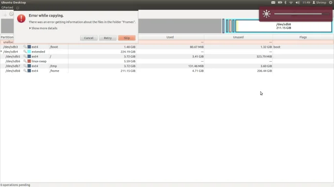

If you could get us a picture of some type of Disk Management window, even from Ubuntu using G-Parted, it might help. Attach using the paperclip on the advanced replies.

Here are some pictured from GParted showing you My Windows 7 HDD and Ubuntu HDD.
Windows 7

Hi
I notice that you have very little free space on the Windows 7 drive.
That can cause problems because there isn't enough space to swap files to it.
