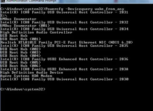

And I don't remember, but have you loaded any special drivers for the unit after the reinstall, like chipset? Does Device Manager show any yellow marks next to a device?
Chewy
Well-Known Member
#16
1) Nothing at all is plugged in to the laptop except the AC Power
2) Running Powercfg -Devicequery wake_from_any gives me the snippet below.
3) No conflicts in device manager
4) No special drivers loaded - Windows 7 picked up everything

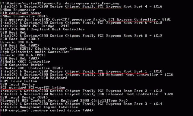

I was also looking at the report you did provide and notice some rather large differences from mine. I realize we have different systems and of course the reports will be different, but it seems some things that should be fairly important are not in your report. You can reference mine in the attachment.
Your report mentions USB almost exclusively, plus Audio, Ethernet, UMBus and HDA modem.
If you notice, mine has many references to the chipset, which makes me a little suspicious as to why yours does not.
