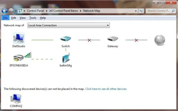

The Windows 7 network map also gives odd readings (see image). It shows the connection to my printer but states that it cannot map to my Compaq computer. Furthermore, it shows that I do not have a connection to the Internet – but I DO.

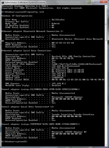

Thank you for responding. I have attached an image of the ipconfig /all result. Incidentally, I have an OpenDNS account but have not used any of the settings - will that help?
Try plugging in OpenDNS or Google Public DNS settings. Some instructions can be found here: http://windows7forums.com/windows-7...nnection-other-devices-do-not.html#post223790

However, this does not address the underlying problem which is that my computer reports no connection to the Internet (according to the map - see earlier image) and also reports that I have no network connection when I know that I have got a connection. Moreover, I still cannot set my profile to Home and Work rather than Public. Any suggestions?
