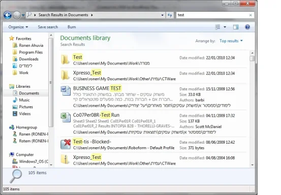

Recently i started to have this strange problem with windows desktop search:
When trying to search the entire index, not a specific location on the disk or inside MS Outlook, there are no results what so ever.
Take a look at the attached picture - [Search problem-Entire index]
When I'm searching a specific location - Everything's fine. Take a look at the attached - [Search problem-Specific location]

It's very strange, but now everything works just fine.
I took the advise of Mitchell_A and enabled the "search other files and libraries" in the Start Menu settings.
Then, I searched for something using the start menu search and clicked the "see more results" link in the bottom.
The standard windows search opened and displayed the anticipated results.
From that moment on - Windows Search is back and working fine for me. It search's the entire index (After pressing [Windows key + F]) and i can use it with or without the start menu search.
To be certain, I disabled the option to search for other files in the start menu and the problem returned!
