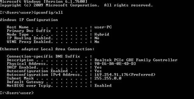

As I mentioned initially, my Linksys router had the same issue. I have just borrowed a laptop, (W7 Home Premium 64bit) and also I cannot get a connection to the router. I have changed ethernet cables. No result. I am wondering, now that 2 routers and 2 computers cannot connect, the final piece of hardware is the modem. This is beyond my experience but do you think there is some sort of issue with it? Here is the command prompt ipconfig/all for my pc direct to modem (no router) View attachment 8330
Trouble
Noob Whisperer
#9
Connect your pc to the new NetGear Router with the ethernet provided with the router, and try this
type ncpa.cpl into the search box and hit enter
select then right click your wired adapter (local area connection) and choose properties
scroll as necessary and uncheck the box next to Internet Protocol Version 6
select / highlight Internet Protocol Version 4 and click the properties button
make sure that both
Obtain an IP address automatically and
Obtain DNS server address automatically
are both selected and click OK
now select the Configure button near the top of your Local Area Connections properties dialog box
In the resultant dialog box select the Advanced tab at the top
look for a reference regarding Speed and Duplex (may say something like Link Speed)
select that and in the right column choose the drop down in the value box and choose 100 half
look for something called Network Address (may also say physical address)
if the Value Box says not present
change it to the other radio button and copy and paste this into the value box
90E6BA0E4DD3
OK your way back out of there and reboot
Keep us posted.
