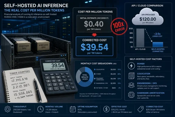

SitePoint’s example assumes $36,000 in used H100 SXM hardware amortized over 36 months, two GPUs drawing an average of 500 watts, a 1.4 power-usage-effectiveness multiplier, $0.13 per kWh electricity, $700 monthly colocation, $100 in software, and 25% of a senior engineer costing $192,000 annually. The article’s formula correctly returns approximately $5,931 per month.
The next calculation does not. The guide defines monthly volume as daily token volume, measured in millions, multiplied by 30. At 5 million tokens per day, that is 150 million tokens per month. Dividing $5,931 by 150 produces $39.54 per million tokens.
SitePoint instead states that the same arrangement yields “~$0.40 per 1M tokens.” That figure would require around 14.8 billion tokens per month, or about 494 million tokens every day—not 5 million. The error is not a minor rounding issue: it cuts the reported unit cost by a factor of roughly 99.
The article then carries the mistake into its break-even story. It says the deployment reaches parity with GPT-4.1 at roughly 5 million tokens daily and recovers the $36,000 hardware investment in about six to seven months. Neither claim survives the article’s stated assumptions.
OpenAI lists GPT-4.1 at $2 per million input tokens and $8 per million output tokens. With SitePoint’s assumed 70% input and 30% output mix, the blended rate is $3.80 per million tokens. At 150 million tokens per month, GPT-4.1 usage would cost about $570 monthly before discounts and cached-input effects—not the $7,500 to $15,000 monthly range asserted in the guide.
The result is straightforward: $570 in API spending cannot cover $4,931 in monthly operating expenses, let alone repay a $36,000 hardware purchase. Under that scenario, there is no financial break-even.

The $5,931 example costs $39.54 per million tokens
SitePoint’s example assumes $36,000 in used H100 SXM hardware amortized over 36 months, two GPUs drawing an average of 500 watts, a 1.4 power-usage-effectiveness multiplier, $0.13 per kWh electricity, $700 monthly colocation, $100 in software, and 25% of a senior engineer costing $192,000 annually. The article’s formula correctly returns approximately $5,931 per month.The next calculation does not. The guide defines monthly volume as daily token volume, measured in millions, multiplied by 30. At 5 million tokens per day, that is 150 million tokens per month. Dividing $5,931 by 150 produces $39.54 per million tokens.
| Scenario using SitePoint’s stated assumptions | Correct result |
| Monthly TCO for the two-H100 colocation deployment | $5,931 |
| Monthly volume at 5M tokens per day | 150M tokens |
| Self-hosted cost per 1M tokens | $39.54 |
| GPT-4.1 monthly cost at a 70/30 input/output mix | $570 |
| Self-hosting operating expense before hardware amortization | About $4,931 per month |
| Break-even against GPT-4.1 at that traffic level | It does not occur on cost alone |
