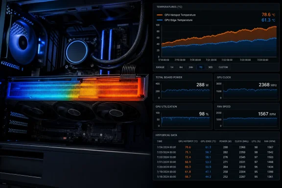

TIMBER 4.19 adds long-term thermal monitoring for AMD Radeon RX 7000- and RX 9000-series graphics cards, using the difference between GPU Edge temperature and GPU Hotspot temperature to flag a card whose cooling behavior changes over time. The practical value is not a new on-screen temperature readout: it is a way to detect a rising delta under comparable load before an owner concludes, from one hot gaming session, that a cooler or thermal paste has failed.
Igor Wallossek’s August 2 report at Igor’sLAB describes the AMD addition as an extension of TIMBER’s earlier NVIDIA Blackwell work. The Radeon implementation deliberately gives up the spatial die analysis available on Blackwell hardware rather than synthesizing equivalent-looking sensor data from values AMD does not publish. That restraint is the right call, but it also defines what TIMBER can and cannot establish on a Radeon card.

A hotspot that rises while Edge temperature stays nearly steady is a different pattern. Igor’sLAB offers an illustrative case where GPU temperature rises by 1 K but hotspot temperature climbs by 7 K, moving the spread from 19 K to 25 K. That does not prove paste pump-out or a damaged contact surface. It does identify a more concentrated thermal change than a uniform rise in both readings would.

The measurement is the gap, not the headline temperature
TIMBER’s Radeon model is straightforward:That distinction is more important than it may first appear. A single GPU temperature is affected by room temperature, case airflow, dust accumulation, fan curves, game workload, resolution, power limit, voltage tuning, clock behavior, and cooler design. It can tell an owner that a card is running hot, but it does not by itself explain whether the source is general cooling or a local change in heat transfer at the GPU package.Hotspot-to-Edge spread = GPU Hotspot temperature − GPU temperature

The strongest part of the Radeon implementation is not the spread calculation; it is the decision to log the surrounding operating state. TIMBER records the temperature pair, calculated spread, timestamp, Total Board Power where available, GPU clock, utilization, fan speed and fan setting, plus memory temperature. This is what turns a useful formula into a potentially useful historical monitor.A GPU reported at 99% utilization is not necessarily operating at an equivalent thermal condition from one session to the next. A frame cap, resolution change, game engine, driver revision, undervolt, clock limit, power limit, or different scene complexity can all leave utilization near 99% while materially changing watts through the board. The same 20 K spread at 100 W and 300 W is not a like-for-like result. Igor’sLAB makes that point explicitly, using a 280 W board-power point as more useful than utilization alone.
