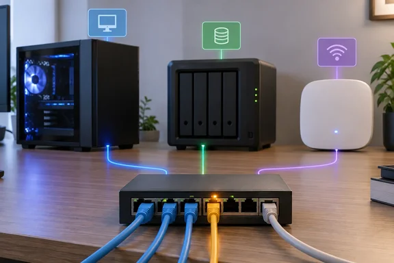

A desktop computer, NAS storage, and Wi‑Fi router connect through a multiport Ethernet switch.
Your cheap unmanaged switch is great at one thing: being forgotten. That's also how it ends up as the quiet bottleneck in a network that has otherwise moved on. A 2.5GbE desktop, a NAS with two ports, and a Wi-Fi 6E or Wi-Fi 7 access point can all sit behind a box that was bought for a few ports and a low price.
